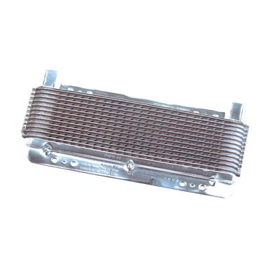

This is a B&M and the one I have used on several Boss Hoss's. The factory also uses this one.

I think the cooler Adrian posted works for most single and 2 speeds. It is the stock cooler on the '03 and later bikes and I run a temp gauge in the trans case and have never seen the trans over 200. And that was in Sturgis, 90+ degree day, 2 up in Needles & Iron Mtn. Most of the heat issues on the tranmission was when the factory was mounting the coolers behind the radiators and drawing hot engine temps across them. I don't think heat has been an issue on the '03 and later bikes with this cooler.
This cooler mounts very nice on the front crossmember and stays out of the way. One other thought, I would not suggest a thermostat control on any cooler unless it is an auxillary cooler like Jack runs. The fluid needs to be flowing for the trans to work and cannot be resrticted or it is gonna build heat pretty fast. Doubt if a single cooler would than be able to 'catch up'. Just my thought.
