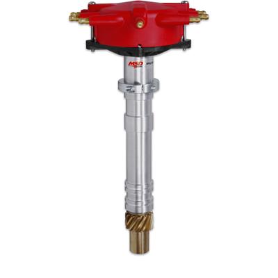

The one you are showing requires a computer. This is the one I would use.
Part number MSD-8489
Adrian

I am actually using #MSD-85551 Pro-Billet, but the one Adrian posted should give even more room.

The dist I posted will not work for what you want. It does not have a mechanical advance. In other wise it is a race advancd locked out only.
Adrian

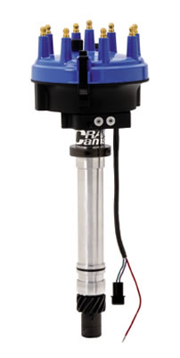

I used this one before and the guy liked it a bunch. It is on a hot rod but what do we have anyway.
Adrian
part number CRN-1000-1500
Add a Crane distributor to your powerhouse.
Crane has taken their years of automotive knowledge and applied them to these billet distributors. They feature a rugged billet 6061-T6 aluminum lower housing, a stainless steel photo chemically etched trigger disc that eliminates flex and corrosion, an aircraft-quality upper bearing for long life and precision alignment, a composite lower housing bearing that holds true alignment, and solid brass cap terminals to ensure maximum current conductivity. They are also fully urethane-sealed against dirt, oil, and moisture, and don't have weights or springs to wear out or break. As if this weren't enough, the distributors have a magnetic trigger that works with most Crane ignitions and many others. Add to that nine electronically programmed "mechanical" advance curves and three electronically programmed "vacuum" advance curves, plus the "zero" position that provides an advance lock-out for crank trigger ignitions. A built-in precision M-A-P sensor, a race-proven optical trigger for precise firing and reliability, and accuracy to +/- .5 degrees at all rpm levels are all added bonuses from Crane. These features make for spectacular, maintenance-free distributors that are at home in street, race, marine, and off-road applications.

Adrian...Two years ago I ordered one of the Crane units you have posted.
I sent it back because of two issues. First, the most aggressive advance curve had it all in at 2500 rpm and I didn't think that was aggressive enough. Second, the ignition module was very big (8"+ long) and I couldn't think of a goood place to mount it.
What do you think about the advance thing and where did you mount the module?...Joe

I put this one on a 32 street rod high boy and we put the Module under the dash. I never looked at it very close because we had a bunch of room.
Unlike Lamont I don't need any extra room on my bike. All I feel we need is the advance by Crane, good wires, with cap, rotor and maybe a MSD coil.
Adrian
Adrian...Are you saying the Crane fully electronic unit will work without a control module? I don't know what these modules do other than to have a rev limiter and produce multiple sparking. Frankly I don't need either of these features...Joe

No Joe, it does require a module but in a car you have all kinds of room that we don't have on a Boss.
Adrian
Adrian..that module is 8 1/2" long and HEAVY. Suppose we could find a place to mount the module the other thing is that the most aggressive advance curve it offers is all in at 2500 rpm. That means you won't be at full advance on the highway till over 80 mph with a two speed. What do you think?...Joe
