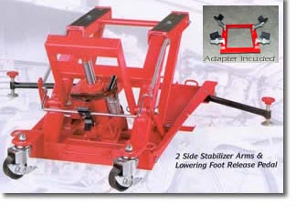

It looks just the Larkin/Sears/etc lifts for HD........they will probably handle the weight but they are not going to be very stable because they are narrow and 1500# is really on the edge for them.
To adapt, you have to fabricate a pair of frame lifts that will support the bottom frame rails and leave sufficient room to clear the pan/exhaust/etc........I think several have done it.....but don't know how successful they have been. One of the problems adapting these lifts is going to be the extra length in the arms to go under the Boss and hit both frame rails. Someone on here may have photos of their fabrication.
Wag & I were going to have our lifts changed to do the Bosses, but after looking at the Pitbull in Sturgis, I decided to cough up the $500 for it...........the Pitbull works really well and is really stable with thebike up high.
Tim
